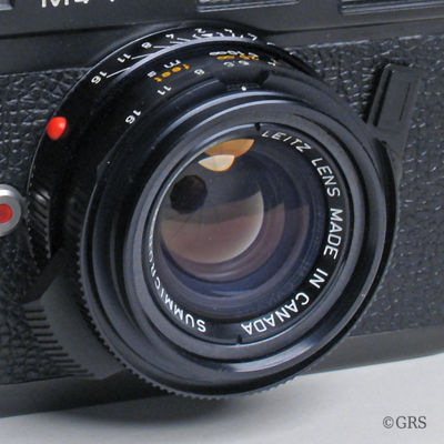

35mm f/2 ASPH Summicron-M - 1997-Current
35mm f = 3.5 cm 1:2 Summicron I
35mm f/2 Summicron II
35mm f/2 Summicron III
35mm f/2 Summicron-M IV
