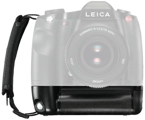

- 16004 - Hand strap (shown)

- 16028 - Multi-function Handgrip S (shown)
