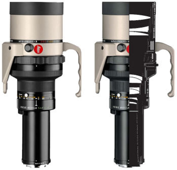

- Leica Order No. - 11 858 / LLC - 199
- Era 2005-Current / Serial Nos. -
- Lens mount - LEICA R-bayonet for LEICA R3 to LEICA R9 with mechanical, and, for LEICA R8/R9, additional electronic exposure control
- Number of lenses/groups - 9 / 7
- Focusing range - 2.15 m / 7 ft < ∞ can be focused beyond infinity, focusing does not have to be corrected for IR-photography
- Aperture - f/5.6 > f/22 - Preset diaphragm with clickstops (including half values), Fully automatic diaphragm
- Smallest object field/Largest reproduction ratio - 75 mm x 113 mm / 1:3.1
- Angle of view (diagonal, horizontal, vertical) - 4.4°, 3.7°, 2.5°
- Position of entrance pupil - 409 mm / 16.1 in (related to the first lens surface in light direction)
- Scales - Combined meter/feet graduation
- Filter mount/Lens hood - Series 6 filters in filter drawer / Built-in, telescopic, rubber-armored front edge
- Accessories - APO-EXTENDER-R 2x
- Viewfinder - Camera viewfinder
- Materials - optical glass
- Focal length - 558 mm / 22 in
- Length to bayonet flange - 374 mm / 14.7 in
- Largest diameter - 125 mm /4.9 in
- Weight - 4,050 g / 8.9 lb
- Inscription -
- Designer - Lothar Koelsch
- Reviews
