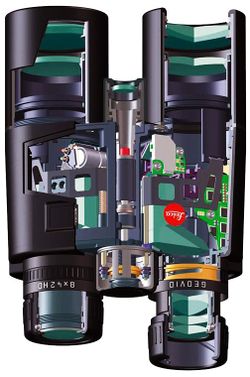

- Names - GEOVID 8 x 42 HD-B /GEOVID 10 x 42 HD-B
- Order nos. - 40 047 / 40 049
- Magnification - 8 x / 10 x
- Lens diameter - 42 mm
- Exit pupil - 5.2 mm / 4.2 mm
- Twilight factor - 18.3 / 20.5
- Field of view at 1,000 m - 130 m / 114 m
- Close focusing distance - 5 m / 16.5 ft
- Diopter compensation - +/– 4 dpt.
- Distance measurement
- Range - 10 m to approx. 1,825 m (10 yds to approx. 2000 yds)
- Measuring accuracy
- +/– 1 m to 500 m
- +/– 2 m to 1,000 m
- +/– 0.5 % beyond 1,000 m
- Display - 4-digit LED display and ambient light based brightness adjustment
- Eyecups with twist-and-pull action - Yes, detachable, with four click-stop settings
- Eyepiece for spectacle wearers - Yes
- Focusing - Internal focusing unit using center spindle
- Lens coating - HDC® multilayer coating AquaDura® coating
- Prism system - Perger-Porro prism
- Waterproofing - Waterproof to 5 m (16.5 ft)
- Body - Magnesium, nitrogen-filled
- Dimensions (W /D /H) - 125 × 174 × 70 mm / 125 × 178 × 70 mm
- Weight - 945 g / 980 g - including battery
- Laser - Eye-safe, invisible light laser compliant with EN and FDA Class 1
- Measuring function - Scanning mode
- Ballistics - Equivalent horizontal range (EHR), point-of-aim correction /holdover number of clicks required on elevation turret
- Bullet trajectories - 12 fixed pre-installed curves - Integration of custom data using microSD card
- Power supply - 1 × 3V CR-2 lithium button cell
- Battery life - ~ 2,000 measurements at 20°C / 68°F
- Scope of delivery - Contoured neoprene strap, lens caps, eyepiece covers, Cordura case, Battery, microSD memory card
