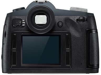

  • Viewfinder system
    • Eyepiece - High eye point viewfinder, diopter compensation from -3 to +1dpt. adjustable on viewfinder
    • Focusing screens - Interchangeable, 3 models available: Ground glass screen with micro-prism ring and split-image wedge (standard), ground glass screen with cross hairs, ground glass screen with grid division.
    • Viewfinder field - 98 %
    • Magnification - 0.87 x with 70mm lens set to infinity and 0 dpt.
  • Displays
    • Viewfinder - LCD line below viewfinder image, for displays see Instructions p. 10
    • Top panel - Colored, self-illuminating OLED (Organic Light Emitting Diode), for displays see p. 11 of Instructions
    • Monitor - 3 inch color TFT LCD monitor with 16 million colors and 921,600 pixels, approx. 100% image field, max. 170° angle of view, anti-reflection/ dirt protective glass Color space: sRGB, for displays see Instructions p. 12

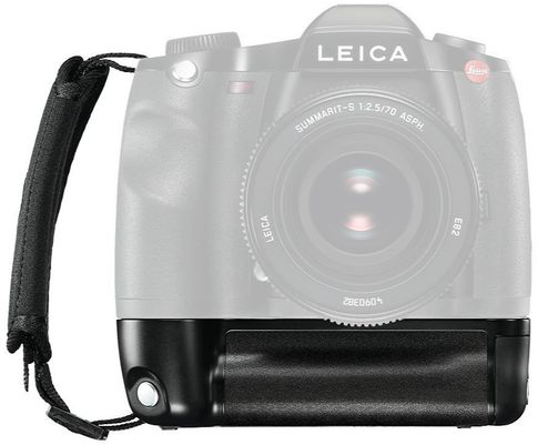

    • Cases, straps, grips and caps
      • 16004 - Wrist strap S (shown)
      • 16006 - Carrying strap.
      • 16010 - Case S
      • 16015 - Eyepiece cap S.*
      • 16021 - Camera bayonet cap S.*
      • 16028 - Multi-function Handgrip S (shown)
      • 16037 - Camera strap S.*
