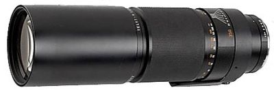

350mm f/4.8 Telyt-R
- Leica Order No. - 11 915 LLC - 195
- Production era - 1980-1993 < 2,650 lenses
- Variants - 3-cam version
- Number of lenses /groups - 7 / 5
- F stop range - f/4-f/22
- Closest focusing distance - 3 m / 9.84 ft
- Smallest object field - 171 x 257 mm /1:7.1
- Diaphragm setting /type -
- Angle of view diagonal - 7 degrees
- Filter type - E77
- Accessories -
- Materials -
- Dimensions length x diameter - 286 X 83.5 mm /11.26 x 3.29 in
- Weight - 1820 g /4.01 lb
- Inscription - LEITZ CANADA TELYT-R 1:4.8/350 MM 2XXXXXX
- Designer - Walter Mandler
- On the street - €EU 1,260 in 2006
