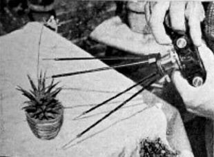

  • Close-up lenses for 5 cm Elmar
    • No. 1 - ELPRO and related lenses originating about 1930, are used for close-up photography for Elmar (I) f= 5 cm 1:3.5 used with BEHOO type adjustable legs. Because legs are attached to the leading edge of the lens they can be rotated with the camera when taking a picture. From the 1933 catalog :
      • Object size - 21 x 31cm to 42 x 63cm
      • Distance to camera - 55 to 100cm
    • (Note: not to be confused with similar lenses for R-camera usage - see ELPRO)
