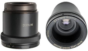

Focotar - 1 1:4.5 / 50 mm
- Production era - 1952-1970
- Code names - DOOUM - DOOHF, 17581 - DOOCQ, 16781 R (optimized for Reprovit II)
- Mount - M39 x 1/26"
- Accessories - DOORX (17675) and REPRO extension tubes - adjustment grip (shown)
- Aperture range - 4.5 /5.6 /8 /11 /16 - GERMANY
- Inscriptions -
- pre-1960 - Ernst Leitz GmbH Wetzlar Germany - Focotar f=5cm 1:4,5
- after-1961 - LEITZ WETZLAR - FOCOTAR 1:4.5 /50 - 16781R
