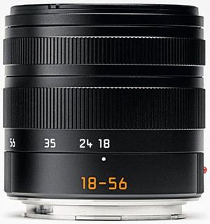

VARIO-ELMAR-T 18-56 f/3.5-5.6 ASPH.
Revision as of 14:16, 26 April 2014 by Tdavis (talk | contribs)
  • Product no. - 11080
  • Production era - 2014-
  • Lens Mount - Leica T stepper motor zoom
  • Focal Length (35mm Equivalent) - 18 - 56 mm (27 - 84 mm)
  • Maximum Aperture - f /3.5 - 5.6
  • Minimum Aperture - f /16 adjustment using dial on camera, third values also available.
  • Angle of View at 18 mm - approx. 75º, 62º, 41º (diagonal, horizontal, vertical)
  • Angle of View at 56 mm - approx. 28º, 23º, 15º (diagonal, horizontal, vertical)
  • Entrance pupil at 18 mm . -37.8 /19.9 mm (at infinity /at close up limit)
  • Entrance pupil at 56 mm . -28 /49.7 mm (at infinity /at close up limit)
  • Setting /Function - Electronically controlled, mode selectable using camera menu: Automatic (AF) or manual (M), in AF mode manual override possible at any times with setting dial.
  • Minimum Focusing Distance - 11.8 in / 45 cm
  • Magnification at 18 mm - approx. 312 x 207 mm /1 : 13.2
  • Magnification at 56 mm - approx. 110 x 73 mm /1 : 7.5
  • Lens Construction - 10 elements in 7 groups w/ 4 aspherical surfaces
  • Filter Ring - E52 mm (non-rotating)
  • Dimensions - length x diameter - 2.4 - 3.5 x 2.5 in /60 - 90 x 63 mm (w/o hood)
  • Weight - 9 oz /256 g
  • Body Material - Black anodized aluminum
