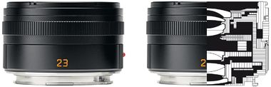

SUMMICRON-T 23mm f/2 ASPH.
- Order no. - 11081
- Production era - May 2014-
- Lens Mount - Leica T with setting dial
- Focal Length (35mm Equivalent) - 23 mm (35 mm)
- Aperture - f /2 - f /16 adjustment using dial on camera, third values also available.
- Setting /Function - Electronically controlled, mode selectable using camera menu: Automatic (AF) or manual (M), in AF mode manual override possible at any times with setting dial.
- Angle of View - 64º, 53º, 35º (diagonal, horizontal, vertical)
- Entrance pupil . -22.7 /10.5 mm (at infinity /at close up limit)
- Minimum Focusing Distance - 11.8 in / 30 cm
- Magnification - approx. 295 x 196 mm /1 : 12.6
- Lens Construction - 9 elements in 6 groups w/ 2 aspherical surfaces
- Filter Ring - E52 mm (non-rotating)
- Dimensions - length x diameter - 1.5 x 2.5 in /37 x 63 mm
- Weight - 5.4 oz /154 g (w/o hood)
- Barrel material - Black anodized aluminum
- Accessories - Caps, Hood 12426 included w/ lens purchase
- Leica Tech Data - SUMMICRON-T 23mm f/2 ASPH.pdf
- Leica data as of July 2014
