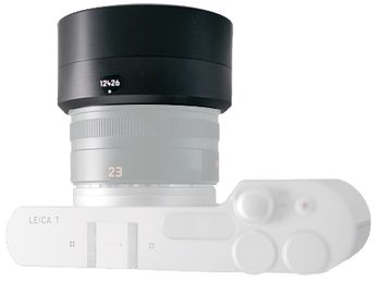

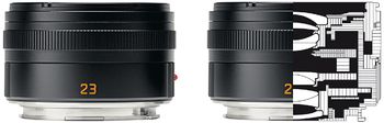

Summicron-T 23 mm f/2 ASPH.
Revision as of 14:41, 25 October 2015 by Tdavis (talk | contribs)
  • Order no. - 11081
  • Production era - May 2014-
  • Lens Mount - Leica T with setting dial
  • Focal Length (35mm Equivalent) - 23 mm (35 mm)
  • Aperture - f /2 - f /16 adjustment using dial on camera, third values also available.
  • Setting /Function - Electronically controlled, mode selectable using camera menu: Automatic (AF) or manual (M), in AF mode manual override possible at any times with setting dial.
  • Angle of View - 64º, 53º, 35º (diagonal, horizontal, vertical)
  • Entrance pupil . -22.7 /10.5 mm (at infinity /at close up limit)
  • Minimum Focusing Distance - 11.8 in / 30 cm
  • Magnification - approx. 295 x 196 mm /1 : 12.6
  • Lens Construction - 9 elements in 6 groups w/ 2 aspherical surfaces
  • Filter Ring - E52 mm (non-rotating)
  • Dimensions - length x diameter - 1.5 x 2.5 in /37 x 63 mm
  • Weight - 5.4 oz /154 g (w/o hood)
  • Barrel material - Black anodized aluminum
  • Accessories - Caps, Hood 12426 included w/ lens purchase
