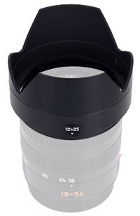

- Accessories - Caps, Tulip hood 12425 included w/ lens purchase
